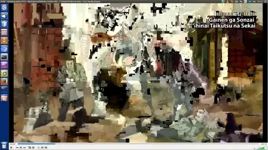

After upgrading from Ubuntu 14.04 to 16.04 I immediately noticed an issue whereby VLC now shows terrible video when you skip around, which only appears to fix itself after a few seconds, which I am guessing when it next meets a keyframe. This can be shown in the screenshot below:

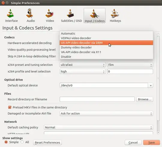

It appears that videos I record using Kazam screen caster are not affected which led me to believe it was some proprietary codec or something. I revisited the decoding menu and found that only this option worked on a local file (I still had pixelation issues on the same video when it was loaded from an NFS folder but maybe that is yet another different issue?).
I am guessing that the DRM option is the important point here as VA-API via X11 did not work (and neither did "disable" or any of the others). I would now be keen to figure out what I need to do when I'm loading the vidoes from an NFS. Increasing the stream output muxer caching didn't fix it.

I had the same annoying issue on KDE Neon (ubuntu 16.04) with nvidia graphics (GTX 1050). I am using the nvidia drivers 375.82. To resolve this issue I had to change two vlc settings:
  1. Video Settings --> Output --> X11 video output (XCB)
  2. Codecs --> Hardware accelerated decoding --> VA-API video decoder via DRM
The second setting is needed to skip through some proprietary files likewmv. As far as I have tested, vlc is now working as before without the nvidia graphics card.

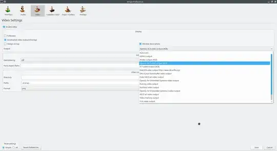

I was able to get mine working with nvidia-367 and nvidia-370 drivers by selecting the VLC Settings > Video > Output as "X11 video output (XCB)" instead of "VDPAU output" which had the lag when skipping. All the (XCB) options worked for me with nvidia-367 including "X11 video output (XCB)" -(didn't work on nvidia-370) and "OpenGL GLX video output (XCB)" -(OpenGL GLX worked after reboot after upgrading to nvidia-370).
List of Video Outputs I have
Basically all the XCB options worked well (skipping, speeds), Color ASCII art worked as normal, the OpenGL (non GLX/XCB) ones aligned to the bottom left but skipped well. ASCII art (black and white) worked OK but couldn't be resized. The others didn't display stuff to screen.
Will think about updating to nvidia-370 as it just came out recently.

I have had the same problem on a Debian Jessie, Nvidia 950 GC with backports Nvidia drivers, and VLC 2.2.4. The update to 367.44-3 version of the nvidia drivers switched the problem.
The solution I found : switching material decoding to "VA-API via DRM". It now works fine.
