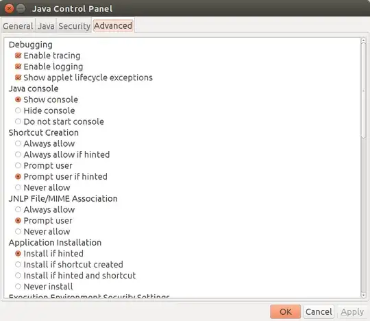

In my case the problem was with absence of XTerm.
I turned on Java Console in Java Control Panel
And saw this in a log
Service needs to be installed for the first time
calling ~/.juniper_networks/network_connect/installNC.sh
Here is the standard error of the command (if any):
~/.juniper_networks/network_connect/xlaunchNC.sh: 1:
~/.juniper_networks/network_connect/xlaunchNC.sh: xterm: not found
After reinstalling xTerm it asked me for sudo password and everything started to work.
P.S. x32 Firefox version is unnecessary - for me it works fine on x64 version
