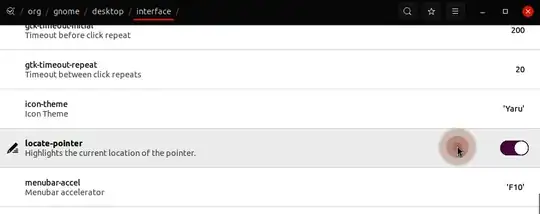

To show the mouse position there is a gsetting key to allow showing the cursor position with orange circles upon pressing and releasing the Ctrl key:
![enter image description here
The key is located in org.gnome.desktop.interface locate-pointer accessible through dconf-editor as shown above or in a terminal with
gsettings set org.gnome.desktop.interface locate-pointer true

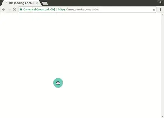

I recently wanted to do this as well. I ended up at this answer which had some broken links and left me still in search of themes that someone else had surely created. I found one I liked. Here's an animated GIF of what I ended up with and how I got it working.

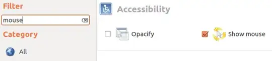

I have not tested this, but I think it's the right answer.
  • Open compiz config: sudo apt install compizconfig-settings-manager && ccsm
  • Look for plugin Show mouse, under Accessibility - ENABLE it..
  • Play with it, to see if that's okay :)
You'll need compiz-plugins package to have this option.
screenshot
