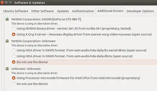

So I figured out how to use Redshift with my system. Basically, I was using the wrong display driver. When I went to the Additional Drivers tab in the Software & Updates app, I noticed I was using default Nouveau driver instead of the latest NVIDIA driver, and had the other tab set to "Do not use the device".
Initial Driver Settings

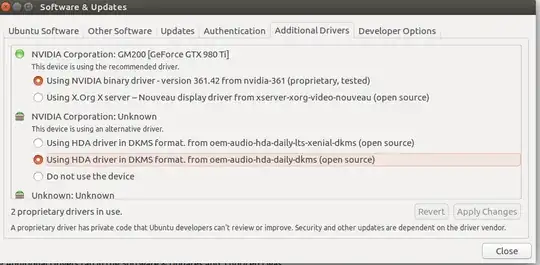

when I switched it to the NVIDIA driver tab and HDMA Driver with DKMS Format (daily-dkms) tab, and restarted the machine, it finally worked.
