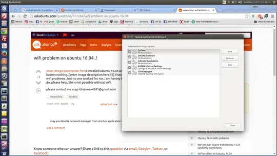

I have installed Ubuntu 16.04 and and there is no sign of wi-fi, no on/off indicator
I have seen all the solutions on internet: enter image description here how to handle wi-fi problems, but none worked for me. I have HP Pavillion laptop.
What can I do?
