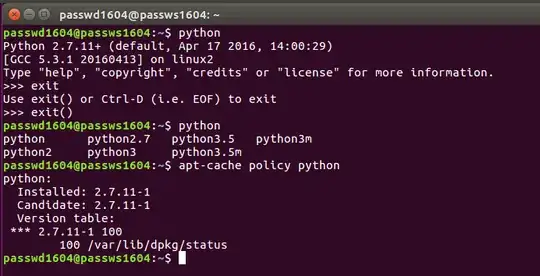

Python both 2.x, 3.x versions are available. if you call python as it is pointed to python 2.x it will load python 2.x
Below image will help you.
