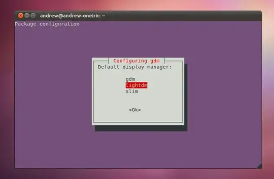

Run sudo dpkg-reconfigure lightdm
You will be shown a screen like this:
Select lightdm, press TAB (to select the OK button) and ENTER.
Then run systemctl disable sddm
If you don't plan on ever using sddm again uninstall with sudo apt-get purge --auto-remove sddm
Reboot and you should be presented with the lightdm login screen (unless autologin is enabled, then you will go to Desktop).
