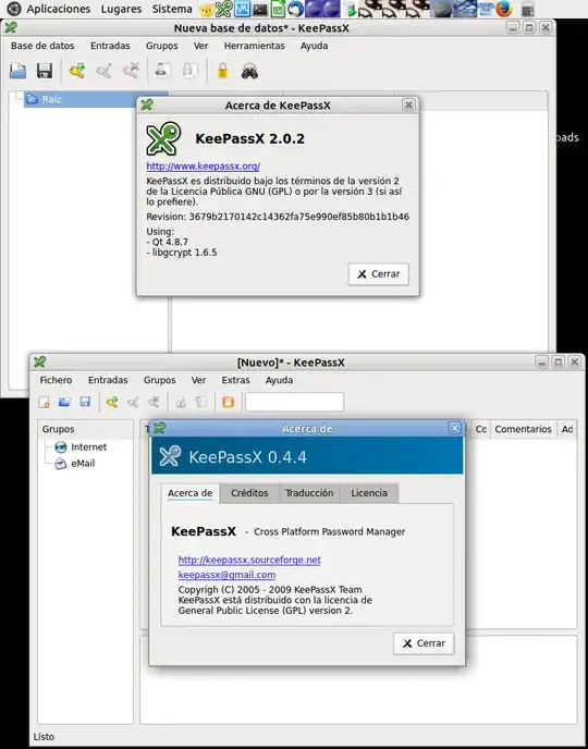

For those of you who prefer to compile old or missing packages or who want to have both KeepassX version 2 and 0.4, you may follow this instructions:
  • Install the build dependencies (sudo apt-get install build-essential libqt4-dev libxtst-dev qt4-make).
  • Download the source code of the last 0.4 version (0.4.4) keepassx-0.4.4.tar.gz
  • Decompress it (tar xvf keepassx-0.4.4.tar.gz).
  • Get into the directory (cd keepassx-0.4.4/).
  • Edit the file src/lib/random.cpp to add the line #include <unistd.h> around line 22 (this is a requiremente to compile with the version of GCC in latest Ubuntu versions).
  • Run qmake to create the Makefile (qmake PREFIX=/usr/local).
  • Run make to build the executable (make).
  • Install the executable (sudo make install). This will put the binary executable in /usr/local/bin/keepassx.
Now, you can create a new launcher icon to /usr/local/bin/keepassx to run the 0.4 version. (You may need to edit the old keepassx launcher to point to /usr/bin/keepassx to run version 2).
This should work at least for Ubuntu 16.04 (Xenial) to 17.10 (Artful).
This is a screenshot of both versions running side by side in Ubuntu Mate 16.04: enter image description here
