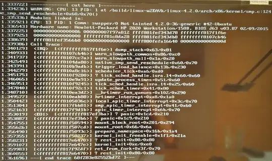

My HP Workstation Z820 is not booting with Kernel > 3.9x
Trying to update to 15.10 or 16.04 fails.
New install of 16.04 from CD fails also - see image..
Studying the image is above my paygrade. However, the first step is to isolate the cause of the problem.
"Boot failure with Kernel 4.x" implies that your system boots with 2.x or 3.x. However, you write that your workstation also isn't booting with 3.9x. This suggests that your system doesn't boot regardless of the Kernel.
If you want to test this, then try installing a system with 2.x or 3.x again. If these also fail, then the cause probably isn't the kernel.
Possible causes:
  • Hardware Failure
Could be USB media/CD-DVD Drive/Memory/CPU. etc...
  • Bad Install Media (Check MD5 or SHA Checksum)
  • BIOS Setting
Another test is try a non-Linux distribution, something like PC-BSD. If this boots, then this suggests that the problem might be related to the Linux kernel. If it doesn't boot, then this suggests hardware failure.
