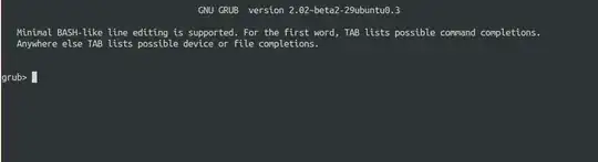

I don't have /boot/grub/grub.cfg present (or older /boot/grub/menu.lst)
It was impossible to install a boot loader during grub configuration:
https://i.sstatic.net/IBEiQ.jpg
Grub failed to install on the available options (/dev/sda /dev/sdb or /dev/md2)

When I run grub-emu, I get a blank prompt:
