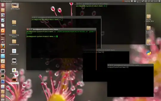

  • I have two users logged in, one (not the current) with two gnome-terminal windows, one (the one in the image) with three gnome-terminal windows, and two xterm windows.
The command:
/path/to/get_terms.sh gnome-terminal
outputs:
while
/path/to/get_terms.sh xterm
outputs:
The script
