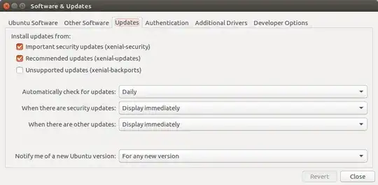

Generally this means that the update process is already running. But in this special case it seems to be a temporarily problem with the Ubuntu repositories update servers today. When you start the computer, the system searches for updates automatically. When you run sudo apt update manually at the same time you receive this message. Today the reason is different, there seems to be an appstream bug. Even when the update process is not running and you execute sudo apt update the process does not complete successfully and the CPU usage gets stuck on 100%. As a workaround -> disable the xenial-backports repository and run sudo apt update again. Now the error should be gone. The bug already has been reported and confirmed on Launchpad.
Reference - bug reports addressing the issue on Launchpad - already confirmed by several users :
Refresh hangs indefinitely, appstreamcli using 100% CPU and apt-get update hangs after hit/get
Update information 2016-05-20 11.00 UTC : solution available in Ubuntu repositories
A fix has been released : appstream 0.9.4-1ubuntu1 libappstream3 0.9.4-1ubuntu1.
After having upgraded to this appstream version you can re-enable xenial-backports.
