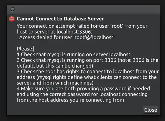

Also two of my Ubuntu 16.04 machines don't seem to be able to connect (Access is Denied errors for root)
It installs okay. It opens okay. But it won't connect to localhost.

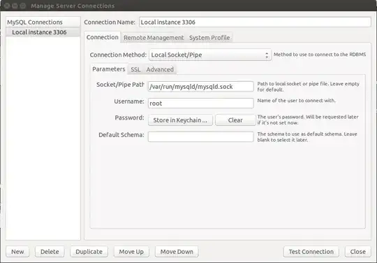

I then had to go into the settings for the root user as shown here. The file location is valid for an ubuntu 18.04 installation.
Root connection settings mysql-workbench.

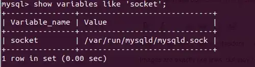

If that socket location is invalid then you'll need to go into the mysql CLI from root or sudo and run the following command.
MySQL CLI command to find the socket.
After you have the correct settings test the connection. It should be successful and you're ready to go.

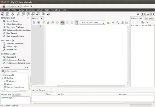

Works fine for me and I did nothing special. Installed mysql-server-5.7 and workbench both from command line and set up a user with a password and set up the normal database permissions (also with the normal method).
And with a database and table:

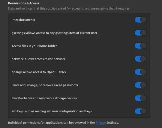

I had the same problem on newly installed 21.04 Ubuntu, after trying all these methods that didn't quite work.
I tried to go into settings and allowed all the permissions and it worked for some reason.
Screenshot of the mysql setting
