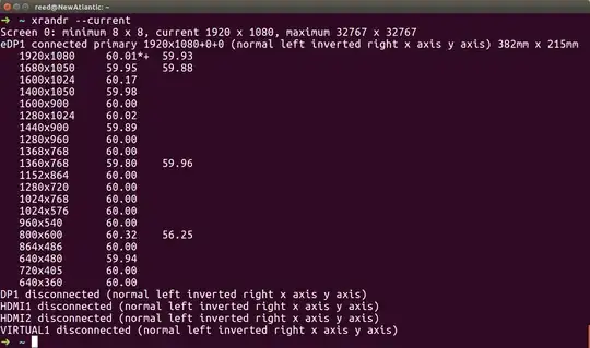

Run this to see a list of your outputs. You're looking for the one that is "connected":
xrandr --current
Here's a screenshot of my list. The output I want is the "connected" eDP1 at the top:
Now you can run these commands to make adjustments. Replace eDP1 with the name of your output, and change 1.2 to make the adjustments:
