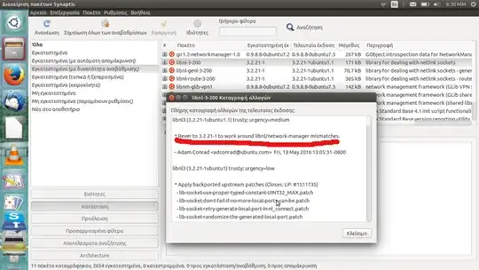

This is caused by a regression resulting network-manager not to be able to start. Here is the procedure to fix it (as this has already been fixed with an update):
  1. revert to an previous version
  2. start network service again
  3. Install the latest updates
Revert to an older version
Open your terminal and issue the following
sudo apt-get install libnl-3-200=3.2.21-1 libnl-route-3-200=3.2.21-1 libnl-genl-3-200=3.2.21-1
Note: if for some reason, the packages are not in the cache folder, you will need to download them from another computer:
Then open a terminal in the folder where you saved them and install them with
sudo dpkg -i libnl-*.deb
Start Network Service
sudo service network-manager start
Then you will be automatically connected to the internet
Reverting to an older version
sudo apt update && sudo apt upgrade
As you can see from the following changlog, this has been fixed and you can safely update
