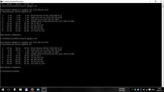

Update
Update 2:
  1. Ubuntu's Wi-Fi is on
  2. Ubuntu's Wi-Fi is off enter image description here
