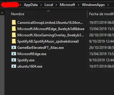

I needed to reset my password also in my Windows 10, I has WLS 1
1- Check your linux/ubuntu name, listing the folder:
%userprofile%\AppData\Local\Microsoft\WindowsApps
In my case I found Ubuntu1604.exe, so I will use ubuntu1604 like name for the next step.  list files in: %userprofile%\AppData\Local\Microsoft\WindowsApps
2- Open CMD with administrator privilegies and run (you will get nothing in return):
ubuntu1604 config --default-user root
3- Start your WSL, check that you get root privilegues or run whoami (you need to be root) and change your password with:
passwd [your-linux-username]
4- Close your WSL and get back to the CMD Window and set back your default linux username:
ubuntu1604 config --default-user [your-linux-username]
5- Start your WSL/Ubuntu/AnotherLinux again, check and enjoy.
