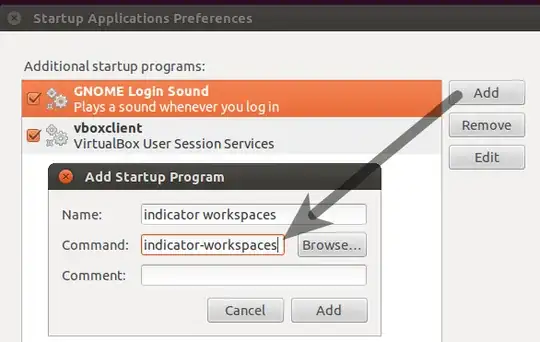

how to start
Finally add indicator-workspaces to your startup-applications (search in Dash for this) if the installation hasn't already added this:

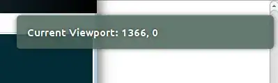

Ubuntu's Unity desktop uses viewports , not workspaces, which is a coordinate-based system.
To know current viewport , you can bind the following set of commands (or place them into a script and bind that ) to a keyboard shortcut:
xprop -root -notype _NET_DESKTOP_VIEWPORT  | awk -F '=' '{ print "Current Viewport:"$2  }' | xargs -I {} notify-send {}
That way you can invoke an on-screen notification to report where are you on the grid right now.
Personally, because I spend 99% of time between firefox and terminal, I've all those commands , set into a function in my .bashrc
get_viewport()
  xprop -root -notype _NET_DESKTOP_VIEWPORT  | \
      awk -F '=' '{ print "Current Viewport:"$2  }' | \
