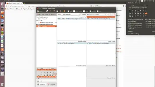

Install Evolution. It synchronises with Google calendar and integrates nicely with Unity.
Here is a screenshot showing my desktop. I have the Evolution calendar open displaying appointments from Google calendar. I have also just clicked on 22 May 2016 in the Unity calendar at the top right and it is showing my next 5 appointments in Google calendar on or after after that date.
Desktop showing Evolution calendar
