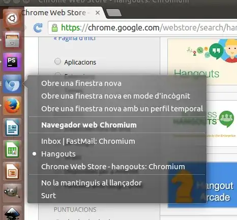

I installed the Hangouts extension, but both hangouts and Chromium share the same entry in the Unity launcher, which makes it very difficult to switch between Chromium windows and chat windows (see image below)

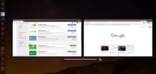

Alse, when ALT-tabbing, window thumbnails are not very helpful:
Is there any way to isolate the Hangouts extension icon from the Chromium windows icon in Unity launcher?
