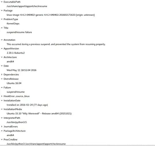

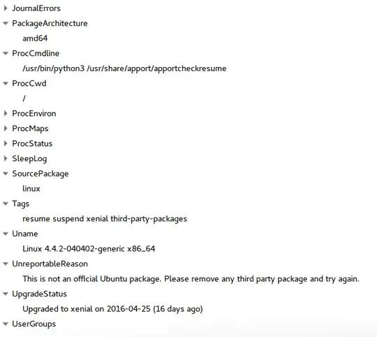

Since I upgraded from Ubuntu 15.10 to Ubuntu 16.04 LTS on my Dell XPS 9350, suspend is broken. When closing my lid the laptop will suspend, but resuming fails and it reboots. I tried pm-suspend and tried resuming, resuming failed and the laptop rebooted. I got the following errors when I got back into Ubuntu. The odd thing in my opinion is that it claims the kernel is not an official ubuntu package. Either way my Linux knowledge is not sufficient to know what's going wrong here.

EDIT: I just tried installing kernel 4.4.8 which should fix some things, but it did not fix this problem. By now I also tried 4.4.9 and 4.6 RC7. None of them fixed it for me.
