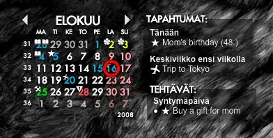

I am hoping for something looking like this:

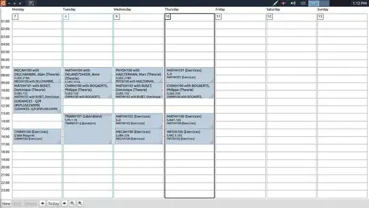

  1. Install dates Install dates
  2. Open Dates
  3. In Calendar > Properties > create new
    enter image description here Provide the link to ical (.ics) calendar; remove https://

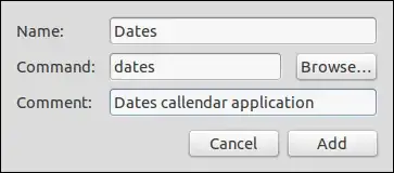

  5. Open Startup Applications
  6. Add
    Name: Dates; Command: dates; Comment: Dates callendar application

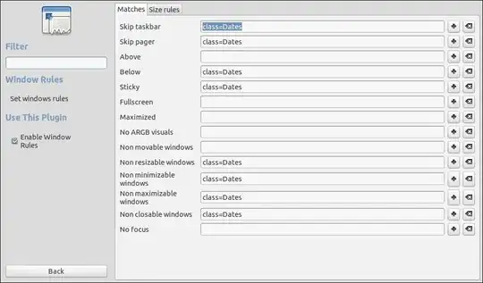

  7. Open CompizConfig Settings Manager
  8. Go to Window Management -> Window Rules

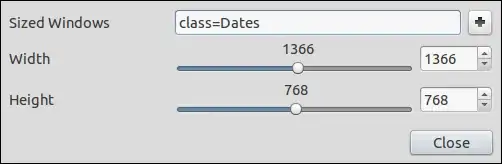

  9. In Size rules (adjust to your monitor) enter image description here

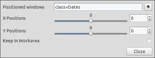

  10. Go to Window Management -> Place Windows -> Fixed Window Placement
  11. Under Windows with fixed positions (you might want to set Y = 24(task-bar height), to show the menu bar)

You could use Rainlendar
The normal version is free; the version including network synced calendars costs ~10€. I got to say, though, those 10€ a couple years ago rank among my best value-for-money purchases ever.
