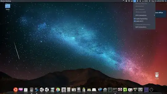

After upgrading from 15.10 to 16.04, when I switch wifi networks using the network manager applet, all networking capability is lost. Before selecting the different wifi network, the wifi works perfectly. After I lose connection, I can restart the wifi using sudo systemctl restart network-manager.service. But I can't switch networks.
At the bottom of this post is a screenshot showing what the applet looks like after the attempt to switch networks: no wifi networks are visible from the applet's list, and the applet reports "device not ready."
Here is the output from lspci -knn | grep Net -A2; rfkill list:

Network Manager applet

You have upgraded to the latest LTS version of Ubuntu, and like many you have been having problems with Wi-Fi. You experienced loss of Wi-Fi on resuming from suspend. This was due to bug 1574347, bug 1311257 or some combination of the two. You found a workaround that worked. However when you switch networks you again lose Wi-Fi connectivity with NetworkManager not seeing any Wi-Fi access points. What should you do?

Step 2 You posted this question on Ask Ubuntu. You posted the results of running the Ubuntu Forums WiFi diagnosis script and a screenshot of your screen. When you did not get a response you posted a bounty on the question. All great moves on your part. We have chatted about your problem and I have analysed your WiFi script results in detail. Apart from a couple of kernel error messages apparently related to the suspend/ resume issue the results show working Wi-Fi that is just not connected to an Access Point.
