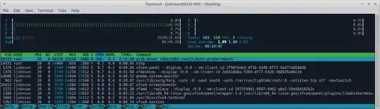

Whenever I upgrade Ubuntu 16.04 and there is a kernel upgrade, the update process takes a very long time when running (os-prober) and also generates the grub configuration multiple times.
os-prober Running
And for some inexplicable reason to me it runs more than once...
