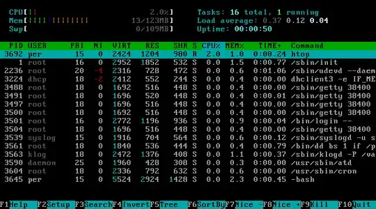

  • Install htop via sudo apt install htop
  • start htop by typing htop
  • Press F6 to trigger the sort-function and select MEM% on the left side via arrow keys
As a result you get a dynamic list of all processes sorted by mem-usage
