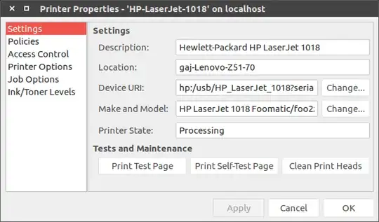

I have a weird problem I cannot trace a cause to.
I successfully install HP LaserJet 1018, through Printers / Add Printer / (recognizes the USB connected printer) / select HP / Select driver / Printer successfully installed and I see it in Printers. It's USB connected. When choosing driver, I try the recommended (HP LaserJet 1018 Foomatic/foo2zjs-z1 (recommended).
However, attempting to print says processing, then completed, but nothing comes out, there's no reaction from the printer.

the problematic printer is LaserJet 1018. Others are currently not connected, but work fine, either from USB or network.
lpstat -a:
HP-Deskjet-3520-series accepting requests since Čet 21 Tra 2016 20:31:21
After processing, I see completed, but there's no printing.
I'm using ubuntu 16.04 LTS, problem persists at kernels 4.4.0.22 and 4.5.2, and only this printer.
P.S. Worked fine in 14.04 LTS.
Help?
