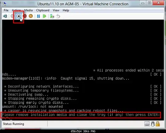

I'm trying to install 16.04 on a virtual machine on my Windows 10 laptop. Everything goes fine with the install with the only variance from defaults is the usage of third party video drivers. I click ok to reboot and it then tells me to remove the installation medium and press enter. It's a virtual machine install, how do I do that without removing my keyboard?

Taken from https://www.eightforums.com/tutorials/5078-hyper-v-create-linux-virtual-machine-windows-8-a.html:
When Ubuntu reboots and stops telling Please remove installation media, click Stop to stop and close vm. This ejects the installation media
and now Restart vm, and you will be able to log in

After installing GnomeUbuntu 16.04 iso on Hyper-v went to the Hyper-v/ Configuration Settings/Bios and moved IDE to 1st boot position. It worked for me.

i found that you just have to restart when you see that screen as it hangs on remove the media, even if i hit enter on my keyboard. If I let it sit, eventually it runs through about a thousand lines of code on screen and errors out. If I just hit reset then it restarts Ubuntu, and then brings me to the login screen.
