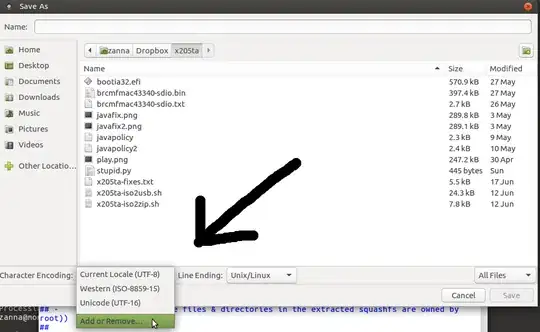

When you click on save as, on the lower left corner you will get some encodings to choose from, choose add and remove (the last entry) and you will get to a list of available encodings including various unicode encodings.

So, I gave Bruni a screenshot for their answer to show what they meant. But then I tested the result. You can indeed select UTF-8 encoding in gedit, or any other text editor. However, unless these files contain non-ASCII characters**, they will be detected as ASCII. Indeed, the same holds if you create a "plain text" (dubious term*) file by any method, and this answer has the reason:
