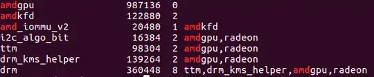

lspci -nn | grep VGA
lsmod | grep amd

The opensource amdgpu driver is for GCN+ class hardware only. Your GPU is a VLIW-based HD 5000 series that works with the radeon driver out of the box, and is NOT supported by the amdgpu driver.
