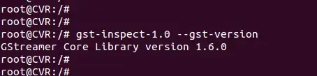

You can use this command:
gst-inspect-1.0 --gst-version
image of command and output in terminal
