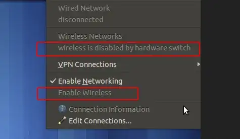

I bought a new laptop (ASUS K401UB). Now, I am encountering a problem with the wifi.
  1. During installation, I was able to detect wifi networks but when I select my wifi, Ubuntu replaces the contents with a text "qualcom atheros..." or so.
  2. Ignoring the selection of wifi, I decided to proceed with the installation but after successfully booting to Ubuntu, Enable Wireless menu is disabled.
Picture is from google
  1. So, I went to System Settings > Network to enable the Wireless but it just wont.

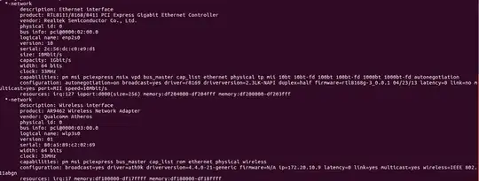

My question is, is there any way to fix this issue? (Please see my LAN driver details below).
Wifi Driver Details
I have tried using both Ubuntu 14.04 LTS, and right now I am using Ubuntu 16.04 LTS. But both of them have the same problem with the laptop. I contacted ASUS for this issue but they wont give support on Linux. The WIFI is the only problem I have right now. Please help.
