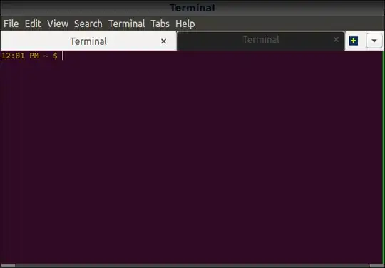

The code I added is at the bottom. The file I edited is ~/.themes/ORIG-Ambiance/gtk-3.0/apps/gnome-terminal.css.
Notes:
  • I just copied over the Ambiance folder from /usr/share/themes and renamed it so that I don't need to use elevated privileges while editing the file.
  • I found that using #555 made it difficult to see the text in the tab.
  • I also changed the selected_fg_color to be sure of which theme is which and that's why the scrollbar isn't orange ;)
