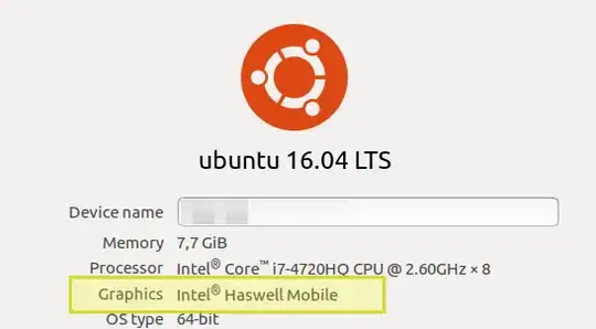

By default, Ubuntu recognizes the Intel graphic card but not the NVIDIA one.

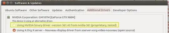

I tried installing NVIDIA's drivers from System Settings > Software & Updates > Additional Software:
But when I restart the system I'm not longer able to access. I see the login screen but when I insert the password I'm brought back to the login screen again.

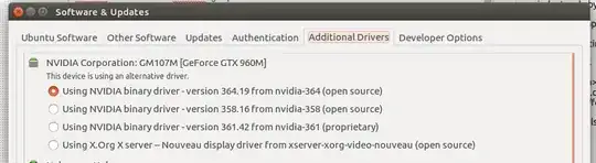

In System Settings > Software & Updates > Additional Software now I see this:
But I still see "Intel® Haswell Mobile" in System > Details (as in the first image above).
What should I do now? How can I enable the NVIDIA graphic card?
