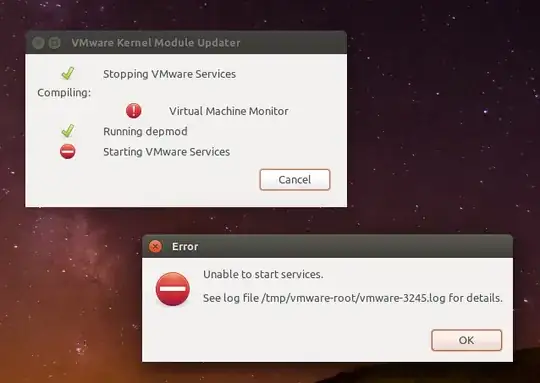

I can't run vmware 12 in my ubuntu 16.04 LTS OS. It always show vitual machine monitor failed.
Here's the screenshot

Using Charly's script on superuser.com/questions/1328401/vmware-workstation-vmmon-broken-on-ubuntu-18-04/, I was able to build the needed modules for kernel 4.15.0-29-generic on 16.04LTS. There is a typo at the end of the script, there should not be a line return between sudo ln -s /lib/x86_64-linux-gnu/libz.so.1 and /usr/lib/vmware/lib/libz.so.1/libz.so.1
Another addition I would recommend is to add sudo /etc/init.d/vmware restart command to the end of the above script.
So the actual solution script with tweaks is:

I solved this problem.
Ubuntu 16.04, VMware Workstation 12.1.0 build-3272444
  1. Disable Secure Boot in my BIOS.
  2. Run
    sudo su -
    vmware-modconfig --console --install-all
In my case, I'm running Workstation 16.0 on Ubuntu 20.10, and I needed to enroll MOK keys using MOKutil before vmware-modconfig would complete successfully.
There's a comprehensive guide here: https://develmonk.com/2020/06/06/whats-wrong-with-vmware-workstation-on-ubuntu/
I had the same problem, the solution was using vmware-workstation-version-12.1.1-3770994. I tried it and it worked just fine.
