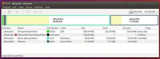

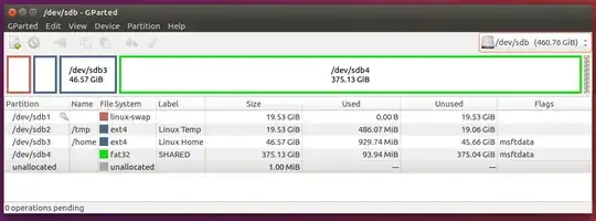

I partitioned the disks as follows (I got this from GParted after booting from the Ubuntu live USB):
/dev/sda
/dev/sdb

I have no idea why /dev/sdb3 and /dev/sdb4 have got "msftdata" flags.
