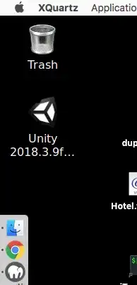

I'm running Lubuntu, and I find that these work fine from a remote shell started with ssh -Y user@linuxbox:
ubuntu-app-launch "qterminal"
qterminal
The first launches qterminal in Quartz and doesn't need to ask my password The second also launches qterminal but needs password
I think the first is also running bash. Have you tried running lxsession ? Although it's unusable, I get this weird new Trash can and the Unity linux installer appearing strangely.
