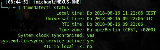

Here an example output of the above timedatectl status command on 18.04 without piping it through to grep:
