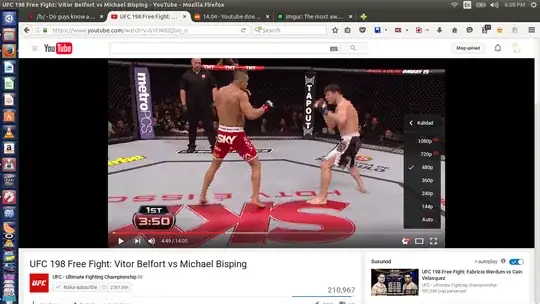

I'm using Ubuntu 14.04 and Mozilla Firefox browser.
When I go to YouTube its default is 720p (HD) but when I try to change it the check mark goes to the quality I pick but it doesn't change. It is still on 720p:
How can I select a lower quality?
