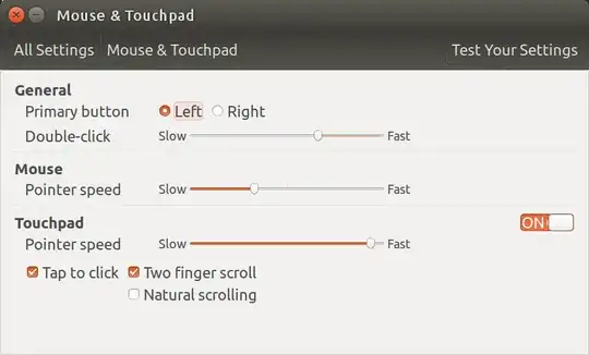

My wireless Logitech MX Performance mouse has DPI of 400 to 1600. To set the speed in Ubuntu I go to System Settings -> Mouse & Touchpad which brings up this display:
Mouse speed
Sliding the "Mouse pointer speed" changes the DPI rate for comfortable use. In Windows Logitech also recommends setting the DPI by sliding the Mouse Pointer Speed. Specifically it says:
  1. Under Pointer speed, adjust the slider to your preferred DPI value. The minimum value is 400 DPI. The speed can be increased in increments of 200, up to a maximum of 1600 DPI.
