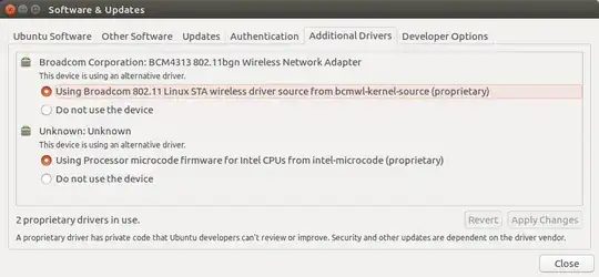

I had the same thing on my Lenovo G570. After upgrade to Ubuntu 16.04 (from Ubuntu 12.04) I noticed that Wi-Fi signal became very flaky.
I fixed the issue by enabling proprietary driver for my wireless adapter (see the screenshot below)
Additional drivers
