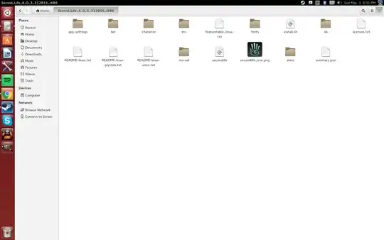

I have downloaded the Second Life package for Ubuntu 14.04 but I am unsure how to run it. What file do I have to click on to set it up?
Second Life Folder

In a terminal, unpack the file, and cd into the resulting directory, which has a name like Second_Life_3_8_2_i686, and contains:
app_settings  etc                     install.sh    README-linux-joystick.txt  res-sdl              skins
bin           featuretable_linux.txt  lib           README-linux.txt           secondlife           summary.json
Run the program in the terminal by typing ./secondlife
