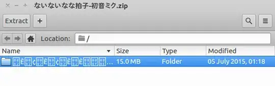

I am trying to fix an encoding issue with any zip files or rar files that I unzip.
Anything I try to unzip through file-roller comes out like this
if using the unzip utility in terminal this is the output

 unzip -O cp932 filename.zip
Option -O cp932 avoid this collapse, I think.
I use this to unzip my japanese encoded zip files:
unzip -O shift-jis filename.zip
file-roller uses p7zip if you have it installed. I don't know how it handles it without p7zip, but the above command should work fine.
for GUI user: Archive Manager (file-roller)
A modified file-roller
https://askubuntu.com/a/611943/413480
https://launchpad.net/~hanipouspilot/+archive/ubuntu/file-roller
install the modified verfion file-roller (or just extract the file-roller in *.deb)
and run with
UNZIP='-O CP932' ZIPINFO='-O CP932' bin/file-roller
file names maybe right.
