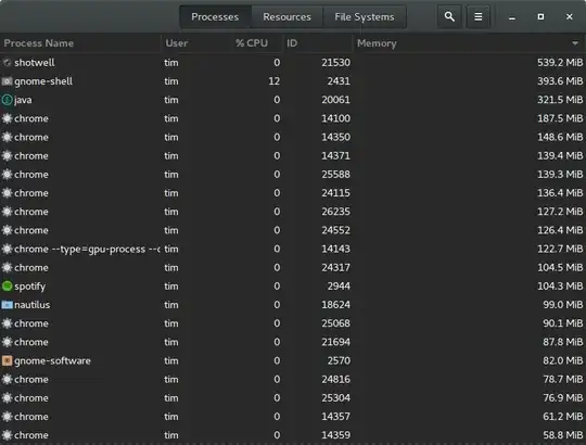

The speed of boot depends on two things: hardware and software.
The more the software does (GUI, animations, background tasks, user management, shell execution, etc) the slower your computer. Kubuntu does a lot more than DOS. If DOS is working for you and does everything you need.
If you need new features, Lubuntu may boot faster than Kubuntu. It's lighter and does less.
Now the hardware. I have a top of the range PC with 32GB RAM, 6 x Intel i7 at 3200 MHz cores and a 2TB HDD at 90MB/s.
You have an old computer with a small amount of RAM, a 333 MHz processor (an order of magnitude slower). You also have a CF card with 30 MB/s read / write.
