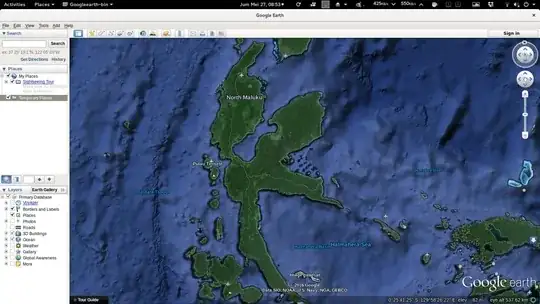

You can try this I managed to do this in gnome Ubuntu LTS 16.04
wget -O google-earth.sh http://drive.noobslab.com/data/apps/google-earth/google-earth.sh
chmod +x google-earth.sh;sudo ./google-earth.sh
If the font in Google Earth Ugly, we can add msttcorefonts using the following command:
sudo apt-get install msttcorefonts
