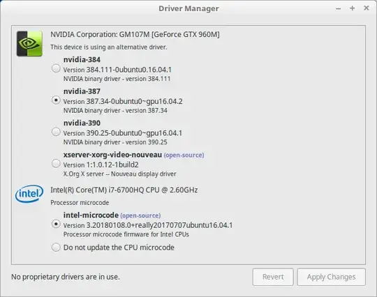

I was just experiencing somewhat the same issue, restarting would take me to a black screen or sometimes a black screen with blinking cursor and it would never accomplish, I have to note I didn't have a problem with shut down.
So what I did was, I opened Drive Manager, and I installed Intel-Microcode firmware for the CPU, I shutdown the computer, and then I tired restarting the OS, and it finally worked.
Changing from Do not update the CPU microcode to intel-microcode
I'm on Linux Mint Cinnamon 18.3 which is based on Ubuntu Xenial Xerus 16.04 LTS.
