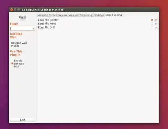

I can solve it from the CompizConfig Settings Manager and check the Edge Flip Pointer from the Desktop Wall settings, but now it will flip to next workspace just when you move the mouse. enter image description here
The Edge Flip Move is a confirmed bug on Ubuntu 16.04 https://bugs.launchpad.net/ubuntu/+source/compiz/+bug/1577328?comments=all

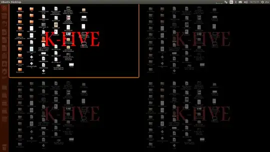

By default move on another work-space Alt + Ctrl + Shift + keys -> and <- Left / right arrow
Also : Can I drag a window onto another workspace?
Also : Drag by mouse to another workspace
Drag by mouse

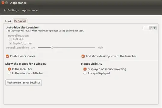

for Unity

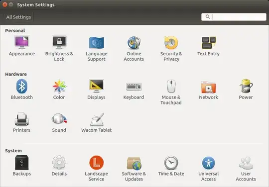

Click on the Appearance enter image description here
Check Enable Workspaces and Add show desktop icon to the launcher enter image description here
