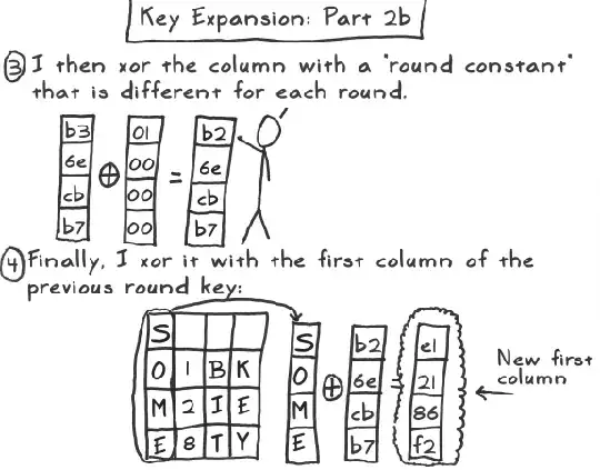

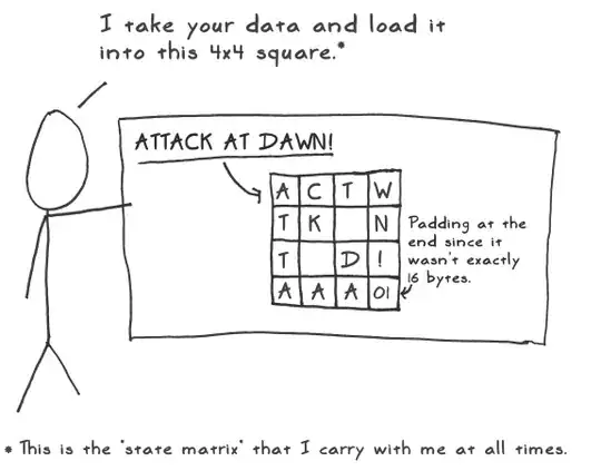

This page has a fun A Stick Figure Guide to the Advanced Encryption Standard (AES) that looks easy to understand, though it looks to be 50+ images, for example these two:
and

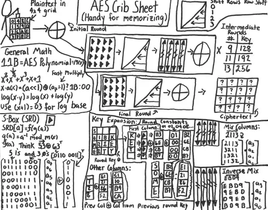

It's far too much to duplicate it all here, but if you have to have an all-in-one image it's this one:
Or, there's a more compact explanation at http://www.password-depot.com/know-how/blowfish_and_rijndael.htm
