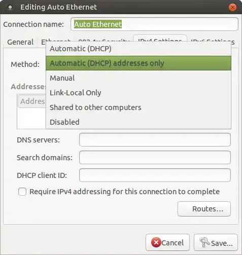

OK, I think I got it - my Auto Ethernet connection was set to Method "Automatic (DHCP)", and I noticed more-less by accident there is another option "Automatic (DHCP) addresses only", so I tried setting that:
nm-screenshot
... and finally, I can have both local Ethernet and broadband connections active - and I can access both local network addresses and Internet.
Hope that was it with this problem...
