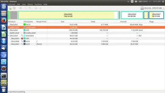

Partition layout
I want to allocate 15 gb free space to /dev/sda6. Can it be done without moving or any damage to system/data?

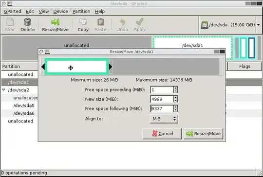

Now start with the first NTFS partition (/dev/sda3):
  1. Right-click on it's entry in GParted's partition list
  2. Select Resize/Move from the menu
  3. In the dialog: Drag the partition from the right all the way to the left: Sample screenshot
  4. Confirm with the Resize/Move button in the bottom right
