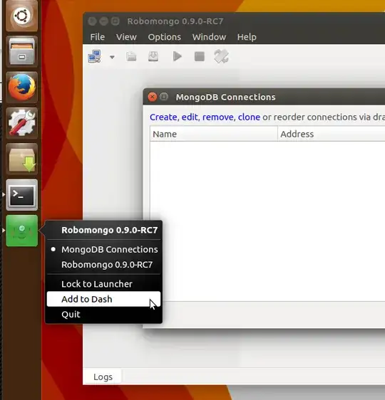

If you then open the application with the command robomongo from the command line you will then have an option (for Xenial at least) on the sidebar to right click and 'Add to Dash' or 'Lock to Launcher':
It is not very tidy but this archive is not a fully developed package as such and lacks neat installation and removal options. However removal can be done manually with the following two commands:
